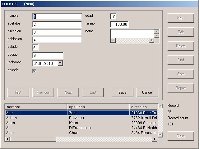

I've attached an updated sources and sample of command EDIT with the following changes:
- added new parameter INIT <aInitArray> to i_edit.ch
- added support for init value at adding record to h_edit.prg
- updated sample with using a new parameter (look at screenshot below)
How to usage:
- just copy these three files to corresponding folders per folder's structure of attached archive
- recompile library libedit.a by command source\edit\MakeLib.bat
- start sample by command build demo
I hope that helps
- Sample Edit.1 screenshot
- edit-screen.jpg (46.04 KiB) Viewed 2400 times
