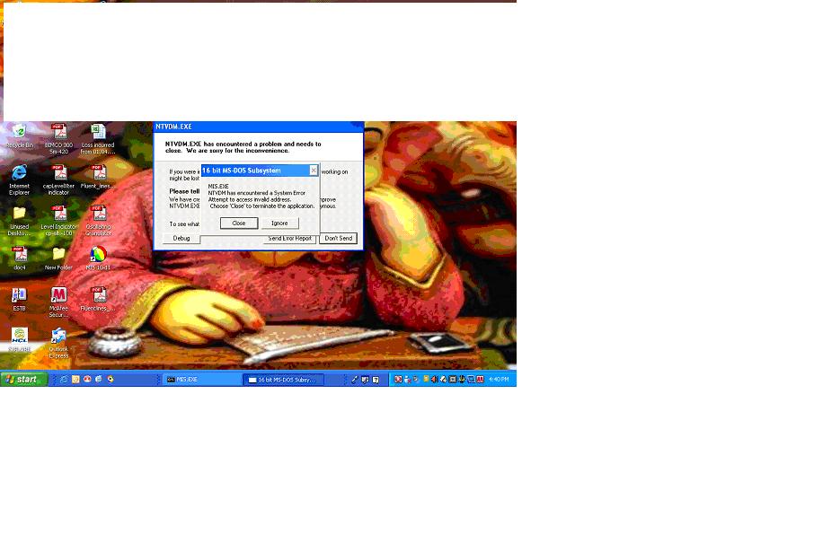

One of our clipper program (the exe:MIS.EXE) is giving an OCCASIONAL - yes not all the time the following error:
NTVDM.EXE has encountered a problem and needs to close.
We are sorry for the inconvenience.
MIS.EXE
NTVDM.EXE has encountered a System Error.
Attempt to access invalid address.
Chooise 'Close' to terminate the application.
First the screen becomes totally "black-out" for quite some time and then returns to Windows Desktop with the NTVDM ERROR.
Please note another Clipper application is also giving same error occassionally, so can't be clipper compilation/linking related issue.
Otherwise both the applications running fine in the same conditions unless this occassional NTVDM comes up...
Attached screen shot for understanding this issue..
NTVDM ERROR BY A CLIPPER EXE IN MS-XP
- NTVDM Error - Clipper Application in XP
- NTVDM Error.JPG (58.7 KiB) Viewed 28315 times
