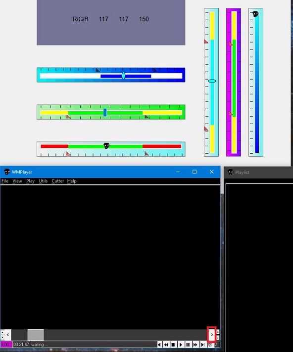

I don't know, how to create slider.
I've tried do use HMG Slider, but, it isn't it

mol wrote: Thu Sep 05, 2019 6:18 am I don't know, how to create slider.
Browse/GRID have Scrollbar "build-in" but if you disable it and use other Control than you must build a new "bridge" between.
when move in Browse/GRID you have to tell Scrollbar new Position. same when move in Scrollbar
as you say you need bigger Button for Touch.
Scrollbar Button depend on Hight of Scrollbar and Wide is calculate by OS (visual Style must fit)
Slider does not have Button so you can make you own Button for navigation
have a look at Slider Sample how to use it
c:\hmg.3.4.4\SAMPLES\Controls\Slider\
c:\hmg.3.4.4\SAMPLES\Controls\ProgressBar\
Note : as i know it have restriction to Range +-32768 ( have something to do with Mouse Move per Pixel )
send new Calculate Position to Browse/GRID and refresh it
