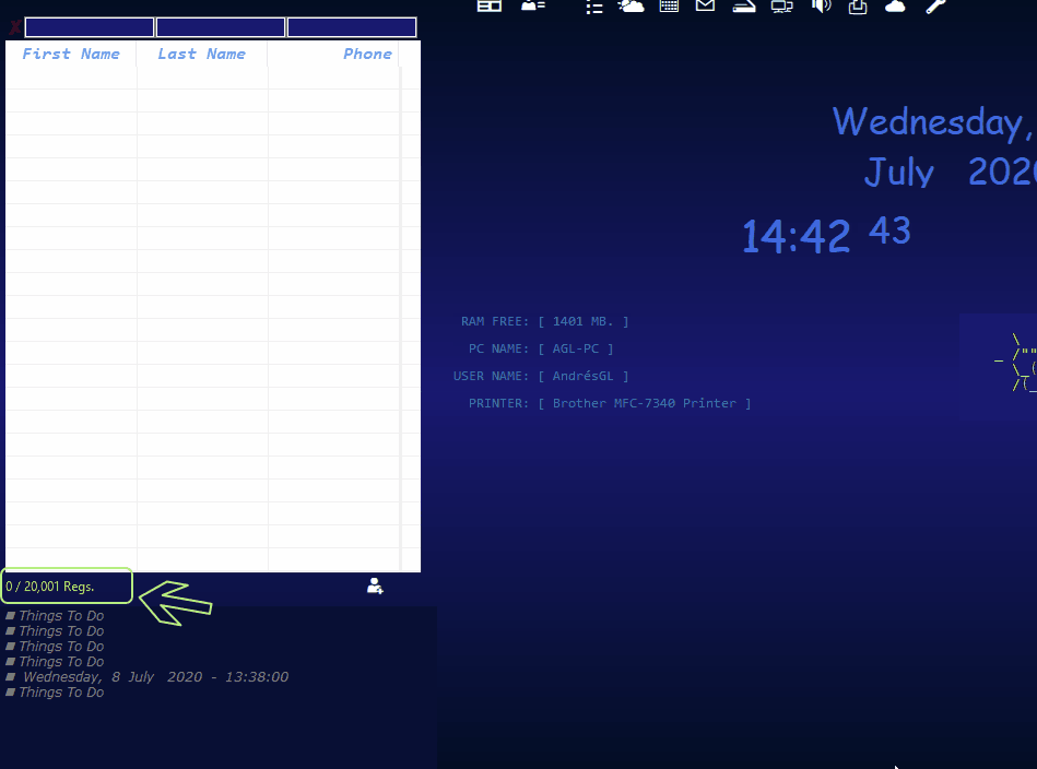

Re: MDB instead DBF
salamandra wrote: ↑Mon Jul 06, 2020 9:43 pm I am facing some problems with DBFs that have about 700 / 800k records (table and index corruption).
En los años que utilice Clipper y ahora HMG, rara vez tuve problemas como estos que mencionas.
Pero es adivinar que puede estar sucediendo:
No utilizar DBCOMMIT() después de grabar, modificar los campos con Indices y tener cerrados el indice correspondiente.
... etc. etc.
Casi siempre he utilizado DBEVAL() y muy poco alguno que otro indice.
In the years that I used Clipper and now HMG, I rarely had any issues like these you mention.
But it is to guess what may be happening:
Do not use DBCOMMIT () after saving, modify the fields with Indexes and have the corresponding index closed.
... etc. etc.
I have almost always used DBEVAL () and very little of any other index.
https://www.hmgforum.com/viewtopic.php? ... val#p45852
http://www.hmgforum.com/viewtopic.php?f ... val#p39392
http://www.hmgforum.com/viewtopic.php?f ... ezl#p36875
P.D.
Esta es una DBF con 20,000 registros SIN INDICES en donde hago una busqueda x 3 campos solo con DBEVAL()
This is a DBF with 20,000 records WITHOUT INDICES where I do a search x 3 fields only with DBEVAL ()

No, mis problemas realmente no son causados por índices cerrados o falta de instrucciones de COMMIT del programa.andyglezl wrote: ↑Wed Jul 08, 2020 7:30 pmsalamandra wrote: ↑Mon Jul 06, 2020 9:43 pm I am facing some problems with DBFs that have about 700 / 800k records (table and index corruption).
... etc. etc.
... etc. etc.
P.D.
