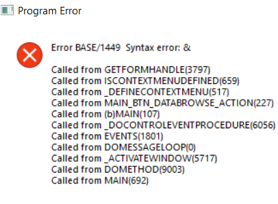

- Posts: 273
- Joined: Sat May 18, 2019 2:11 pm
- DBs Used: Visual FoxPro, FoxPro
- Location: United States of America
Re: RightClick event in a Browse Control
Hi Jimmy and thank you for your kind suggestion.
I need the RightClick's action to be bound to (isolated to) the BROWSE in TAB #2.
To the form's "DEFINE CONTEXT MENU" I tried adding both:
of DataBrowse.Tab(2) (the form/window name)
and
of ThisWindow.Tab(2)
Both compile into an .EXE. But when I click to bring up the modal form:
Shouldn't it be possible for a RightClick action to be bound to a specific BROWSE???
If anyone has suggestions I would really appreciate hearing them. I'm stuck.
Thanks again,
Red2
and
Thanks again,
Red2
