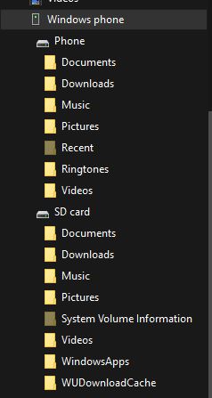

i got a Lumia 550 with Windows Mobile for Test and it have "much more" Folder.
i test it with Code from Marek and it work better with COPYHERE() :)
... but still "seems" to make some "pause" between
the Difference of Marek Code to my first Version are using Array for "different" Object.
i do "stop" if i got right Object to use it as Parent for next Level.
so i use same Way twice to be sure and pass "active" Object for transfer

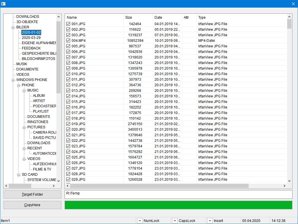

so here now new Design using Concept from Marek with CARGO and Array
it use a DblClick to "build" a Sub-Node "on-fly"
when it have items in Folder it will shown in GRID.
! Note : "transfer" or "Thumbs" are NOT include at this Time ( but Dummy Code is include )

Posts: 2093
Re: path to iPhone DCIM Directory
have work on Transfer and wonder why i got "dupe" Message ... :o
this is on Apple iPhone ... "same" Picture but "dupe" ... :shock:
so have a look on your Phone when you get "dupe" Message ;)
i have add lTransfer as Parameter instead of PUBLIC and include DoCopySingle()
