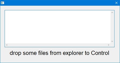

i have made a Sample to Drop Files from Explorer to HMG Control.
HB_FUNC are from MiniGUI but work under HMG
i use CREATE EVENT PROCNAME to get WM_DROPFILES Message.
 CASE nMsg == WM_DROPFILES
Sample is just 1st Step and give you a Array with List of files which have "drop"
i have reduce Code to 32 Bit Version and to figure out how it "should work"

to drag from Explorer to a Control need 3 Steps
1.) DragAcceptFiles function
https://docs.microsoft.com/en-us/window ... ceptfiles
2.) DragQueryFileA function
https://docs.microsoft.com/en-us/window ... queryfilea
3.) DragFinish function
https://docs.microsoft.com/en-us/window ... dragfinish
and when moving
4.) DragQueryPoint function
https://docs.microsoft.com/en-us/window ... querypoint
in Harbour MiniGUI 1.4 Extended (Build 47) added by Grigory Filatov
you will find Source in c:\MiniGUI\SOURCE\c_winapimisc.c
the Source i saw was c:\MiniGUI\SAMPLES\Applications\RunCmd\RunCmd.prg
how it work :
1.) you need a Handle for DragAcceptFiles
this Sample is for Form
   DragAcceptFiles( GetFormHandle('Form_1'), .T. )
to get Handle of Control is
   hWnd := GetControlHandle( cObj, cForm )
2.) you need to get into Windows Message loop
this normal is handle by HMG in c:\hmg.3.4.4\SOURCE\h_windows.prg.
i have used modify Code from USB_Detect Sample
CREATE EVENT PROCNAME Drop_Detect() HWND DropDemo.HANDLE STOREINDEX nIndex
MiniGUI Sample use
SET EVENTS FUNCTION TO MYEVENTS
3.) get WM_DROPFILES Message
FUNCTION Drop_Detect()
LOCAL nHWnd   := EventHWND()
LOCAL nMsg    := EventMSG()
LOCAL nWParam := EventWPARAM()
LOCAL nLParam := EventLPARAM()
      aFiles := DragQueryFileS( nWParam )
MiniGUI have
Function MyEvents ( hWnd, nMsg, wParam, lParam )
   case nMsg == WM_DROPFILES
      cCmd := DragQueryFile( wParam )
"My Problem"
when using CREATE EVENT PROCNAME Drop_Detect() Syntax it only work with Form.Handle NOT with Control.Handle
so i have to try MiniGUI Style with HMG ... this need some more time to figure out how it work.
