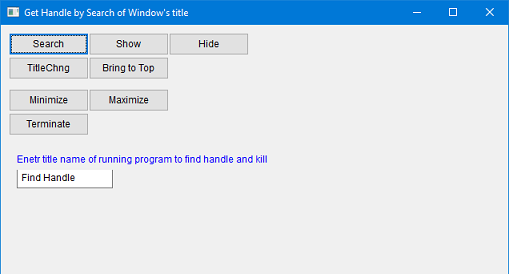

Re: switch to other Form from same App
Refer link it may help you to
Find running program from the windows title / process, once found kill said program
http://hmgforum.com/viewtopic.php?f=5&t ... 513#p39513
- Untitled.png (21.32 KiB) Viewed 2047 times
