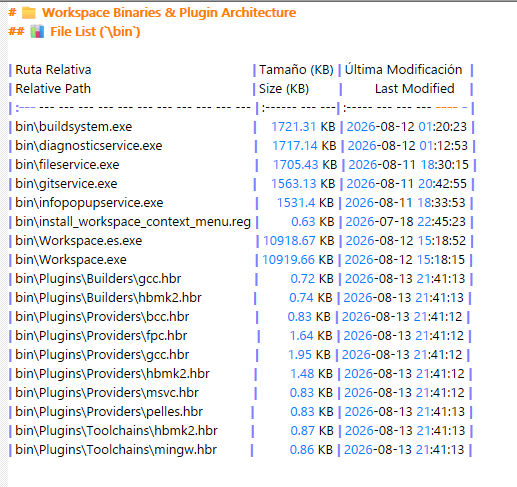

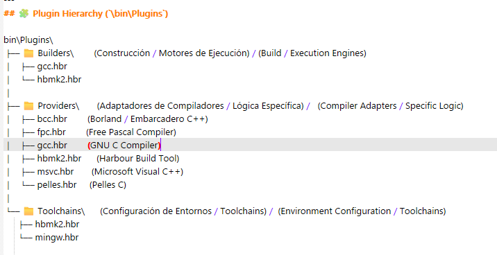

Re: Workspace - development environment
Plugins :
Captura de pantalla 2026-08-13 234814.png (95.51 KiB) Viewed 456 times
Captura de pantalla 2026-08-13 234848.png (43.2 KiB) Viewed 456 times
