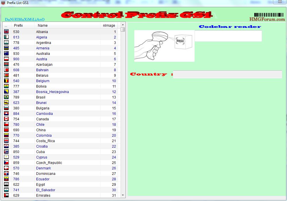

Implementing my POS point of sale application, I needed to have on hand a list of countries (GS1 Prefix) and thus identify the origin of the product for sale.
these prefixes are assigned by the international organization GS1.
you can look at: http://www.gs1.org/barcodes/support/prefix_list

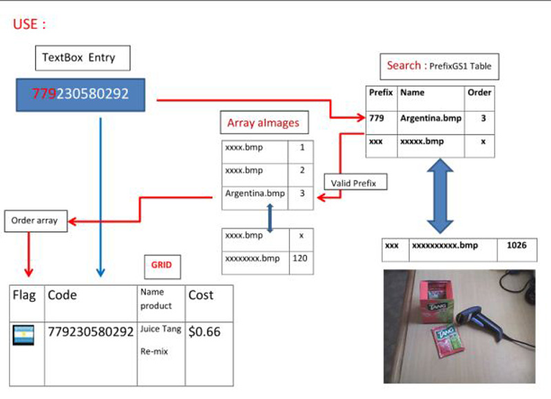

the products handled by the POS system are EAN13 (European Article Number) This application generated from a table of countries and their prefixes, another table containing prefixes, image name, order.
The order indicates the location of the 120 images available from a total of 1026 GS1 prefixes available.
these images are displayed depending on the product entered the POS application, you can couple this code with your application as the same (code) is released for use on my part.
Read my comment in GS1.PRG [attachment=1]GS1 Sources.rar[/attachment]
PD: the application takes a while to load the grid, in my post is instant, can not find the error if you have some time and desire can help me fix this?

In the routine of the POS system of the country image is searched in this way. (This method is being changed to improve the code)
En la rutina del sistema P.O.S la imagen del pais es buscada de esta manera. (este metodo se esta cambiando para mejorar el codigo)
Function CargarItems()                                 /**********************************************************/
Sele 1
Productos->( DBGOTOP() )
    Do While !Eof()
              AADD( aCargarItems ,  { GetCode( Productos->PAIS ) , ;
                                               Productos->CODIGO , ;
                                               Productos->SCS    , ;
                                               Productos->RUBRO  } )
                  Productos->(DBSKIP(1))
    End Do
Return ( aCargarItems )
Function GetCode(nCountry)                          /**********************************************************/
Local nFor            := 0
Local nPosCountry     := 0
Local cPosCountry     := ''
 For nFor := 1 To 111
    IF  STR( nCountry, 3 ) =  aBanderas[nFor][CODIGO_PAIS]
          nPosCountry    :=   Val ( aBanderas[nFor][ORDEN_PAIS] )
          Return( nPosCountry )
    Else
          nPosCountry    := 70
    Endif
 Next

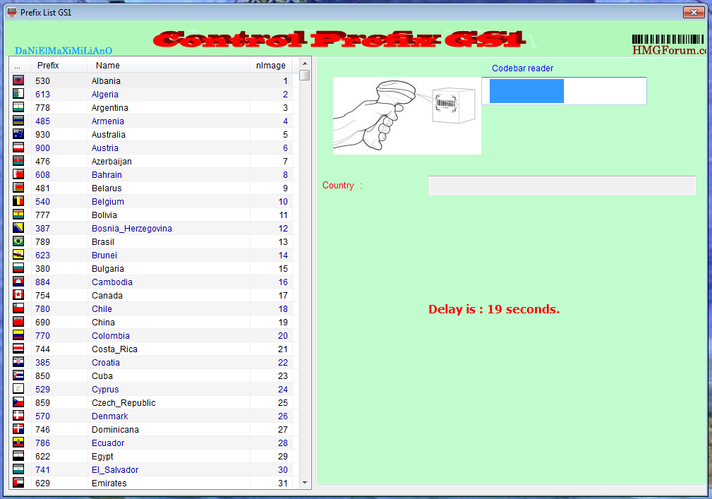

I did some tests for determine reason of delay.
I hope that it help you.
GS1_Test.zip
Slightly modified code of GS1
(5.63 KiB) Downloaded 571 times
Result of delay test on GS1

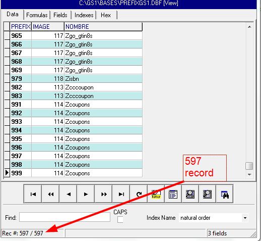

wrong line 142 in GS1.PRG
     GS1(301, 799 , 'France'       ,  34)
Replace with
     GS1(301, 379 , 'France'       ,  34)
DBF .jpg (54.57 KiB) Viewed 9601 times
Before 1017 record
Equal :cry:

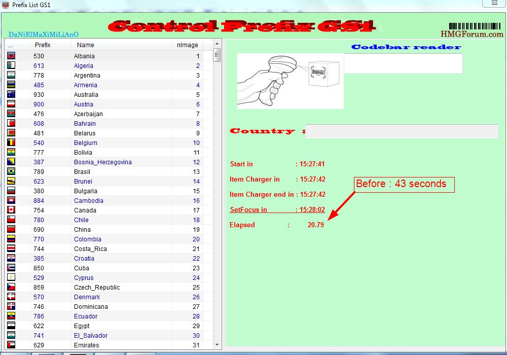

Hi / Hola :
Modificando un poco el codigo gane velocidad.
Translate google : Modifying a bit the code up to speed
Ahora / Now
Prefix List GS1_2012-08-15_15-28-23.jpg (100.29 KiB) Viewed 9589 times
GS1 Source.rar
(452.08 KiB) Downloaded 647 times
