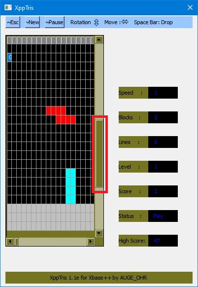

this is a old Cl*pper Game which i had ported to Xbase++ GUI.
now i have test that Source with harbour and got it run under Cl*pper Style :D
as i say i have ported it to Xbase++ using XbpBrowse() which is like TBrowse but GUI.
"Playground" is a Array. depend on Value of a Cell you can see Color.
while XbpBrowse() Version of GTWVG some VAR missing i have used a lot of #IFDF __XPP__
also i have Problem with "Preview" ... it is the same Syntax like "Playground" ...
but my biggest Problem : it does not move/show ... until i use vertical Scrollbar :!:
so what is going on :?:
where does that vertical Scrollbar come from :?:
ok i have disable it while it does not compile

... but "Playground" Array is fix Size so no Reason for any Scrollbar ... :(

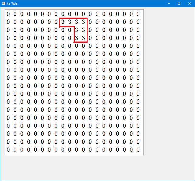

Posts: 2093
Re: hb_Tetris
hi
after i have learn about FMG and GRID i want to continue with hb_Tetris
aPlayground[18][20] is filled with "0" at begin but nothing is shown :o

now i have copy FMG Code to MAIN and now i "see" my Playground.
but i have the same Problem when using ON KEY while it "move" only when press a Key.

Question : can i switch off Cursor in GRID :?:
even if have CELLNAVIGATION .T. i can see Rest of Cursor with other Color.
so what i ask for is to switch OFF Hi-light of Cell. is this possible or do i need Ownerdraw :?:
here latest Version BUT it will crash when reach Bottom ... and it is still alive after crash :o
